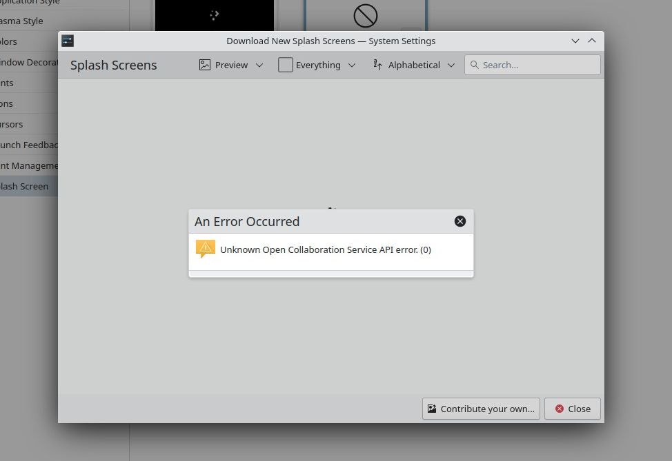

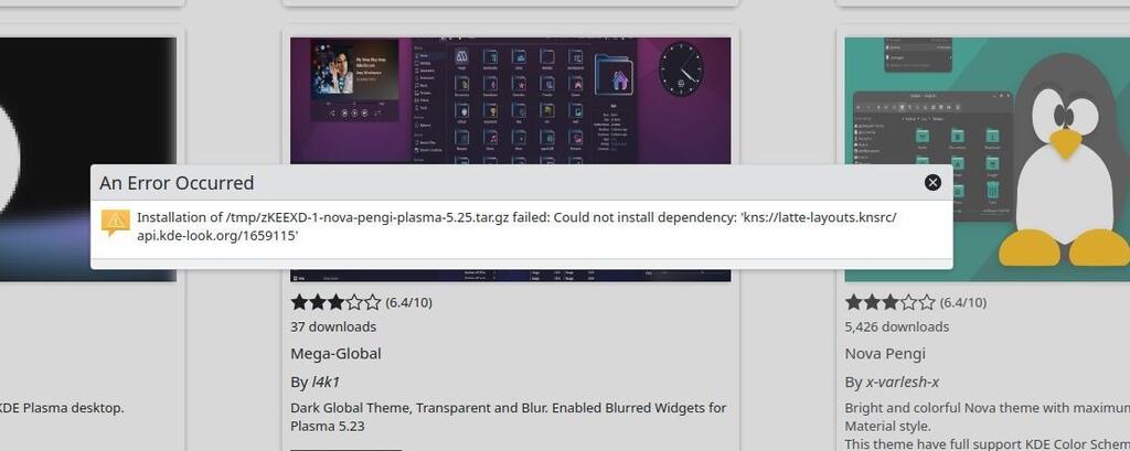

                          Unfortunately, I am hitting a different wall with every new installation attempt. I became an expert in installing and grub management of multiple boot Linux drives, but using Kubuntu eludes me.
                          Also attached, are some of the screenshots taken (and missed taking many others), pointing to the constant problem of trying to add another theme, any theme from the highest rated.
