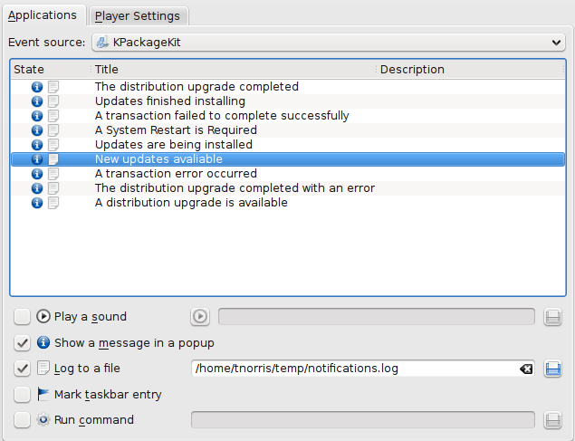

            OK, I had an idea. I've updated all my KPackageKit and Update Notification Daemon settings to log to a file in addition to showing a popup. Lets see what shows up in the file.

                  Originally posted by GreyGeek
                  In Systemsettings, under the General Tab, is the "Notifications" icon. It displays a dialog which allows you to choose "System Notifications". On its dialog is the "Event Source". Chose KPackageKit.
                  Impossible! There no KpackageKit at all! How i add it there?
                  EDIT
                  Ouch i stupid! there is scrollbar.
