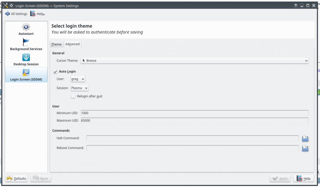

                I'm not to good at doing things like this. Can you tell me where on this page I would put the Numlock=on command?
                  Unfortunately, all sddm configuration options are not exposed in the SystemSettings module...and this is one of them.
                  To make the change, you need to manually edit the configuration file /etc/sddm.conf.
                  We can give you step-by-step instructions on how to do that (if you are unsure), but first check whether the file /etc/sddm.conf already exists on your machine.
