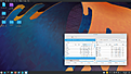

                    Looking at my entire PC screen, across the top, there is a blackened strip going across the top of the screen.
                    Within that strip, starting at the left, is the main Krusader toolbar (in words, not icons):
                    File Edit Go User Actions Tools ...
                    and under Tools is the Start Rootmode Krusader.
                    I didn't do anything to cause that feature to work, but that very top-of-screen menu bar also appears for other apps, like Libre Office Writer.
                    And that top-of-screen main menu bar only shows any options (in words) when I click on the app (in this case, the Krusader window);
                    otherwise, that menu bar is grayed-out. So that menu bar looks like it is part of my Desktop, if that makes sense.

                        That (above) is the full PC Desktop showing at the very top the menu bar for Krusader.
                          i believe that's the KDE Plasma's Global Menu widget thingy
