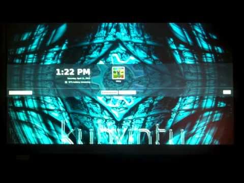

      However I have achieved a seamless background from login to desktop with the system settings tools and a quick dirty hack .
      just replace the /usr/share/plasma/look-and-feel/org.kde.breeze.desktop/contents/splash/images/background.png with the wallpaper you want ,,,,, the .png will be owned by root but should be set group can read and others can read .
      dont know if you half to but I did run kbuildsycoca5 next.
      log out and in,,,,,,,,presto
      I now have your https://www.kubuntuforums.net/showth...67780-that-too running in the login screen the splash screen and the desktop
      the one with the Kubuntu txt for login and splash and the one without for the desktop ,,,,,,,,,,,sweet

                ya the devs keep changing things ,,,,,, the login splash background.png is in /usr/share/plasma/look-and-feel/org.kde.breeze.desktop/contents/components/artwork/ ......now , but now I cant get the system settings>start up and shut down>sddm background to stick ,,,,,,,,
                O ya it's in the sddm ,,,,,/usr/share/sddm/themes/breeze/components/artwork/background.png
                awesome ,,, I was just setting up my new 15.10 install and had forgot about this one ,,,,,,,it's working well @hear .
                but unless you make your own theme like @https://www.kubuntuforums.net/showthread.php?67599-Plasma-5-background-images&p=370231&viewfull=1#post370231 the changed .png's will be over wrote on a update ,,,,possibly .

                  so hears a Vid of my 15.10 firing up ,,,,,,,,,,,,,,,,,,,,,,,,,,,,,,
