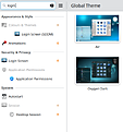

                    Something must be missing, as you are using Plasmalogin, not SDDM - there is a separate config tool for each. The SDDM module is supposed to be hidden when a different logion manager is being used, same for Plasmalogin.
                    oops, I see now:
                    The error is because SDDM is not installed/enabled
                    I can only see the SDDM module if I search for it explicitly, or for “login”, or have toggled the “show inapplicable” option on.
                    So there is a bug of sorts in System Settings for this (and other hidden modules, I assume).
                    It does not appear when digging through the menus manually.

                    This may better show it:
                    Click image for larger version  Name:	Screenshot_20260716_130948.png Views:	0 Size:	115.4 KB ID:	693336​Click image for larger version  Name:	Screenshot_20260716_131141.png Views:	0 Size:	119.5 KB ID:	693337​
                    But I still saw exactly what you did using the correct module, until I didn't.
