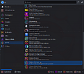

    usually i'm able to access settings via krunner by typing "settings", but now the are two search results on my install
    there is:
    System Settings - which is the usual giant settings page with things like "driver manager"
    but now there is:
    Settings - which brings up some over simplified version of the plasma settings where nothing even shows in the main panel it just tells you to pick something from the list on the left.
    anyone else getting this?

    here is the krunner result window with the new search result highlighted
    Click image for larger version  Name:	Screenshot_20260605_070505.jpg Views:	0 Size:	37.4 KB ID:	692565​
    was this always there and i just didn't notice?
