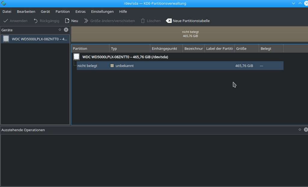

The Kubuntu install software shows only free instead of partitioned space.

        You can see enclosed that I still cannot see any partition, which however exist.
