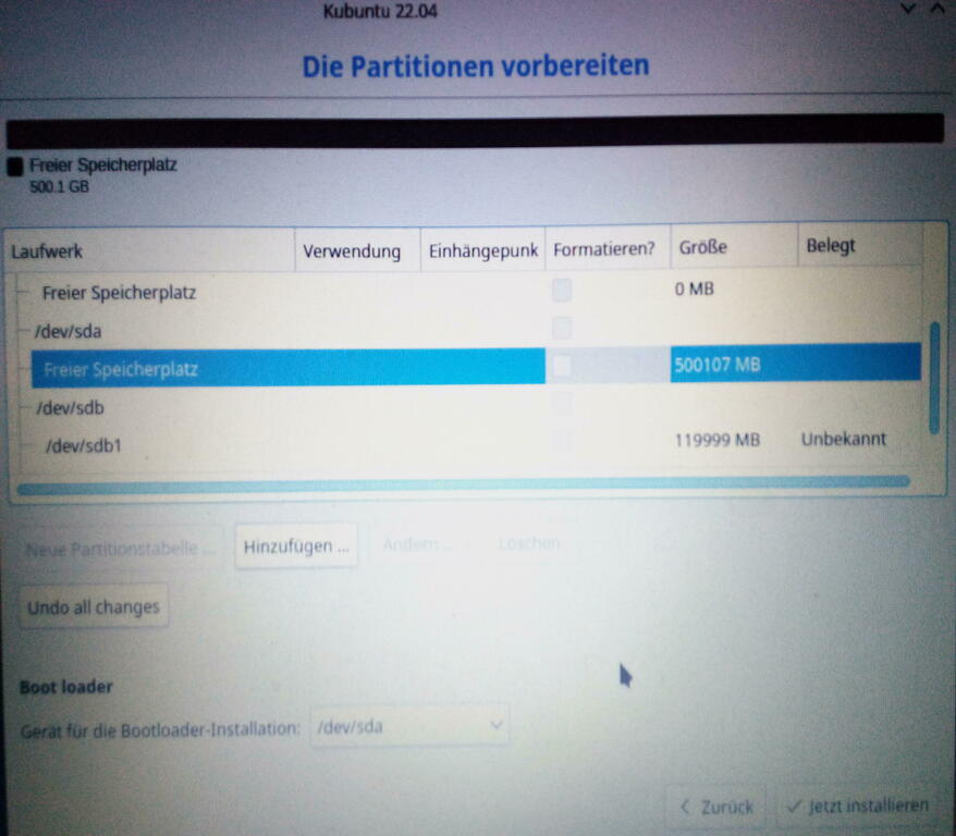

    Hello Everybody,
    I would like to reinstall Kubuntu 22.04 between other systems, that you can see here at the end of the page
    https://www.kubuntuforums.net/forum/...titioned-space
    But during the installation, I can only see 500 GB free space, as is shown by the enclosed picture.
    Could you please help me to install Kubuntu in the second blue square of the afore mentioned picture of the link?​
