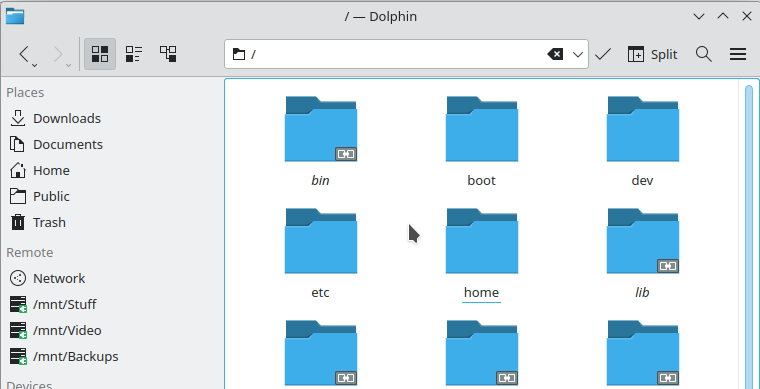

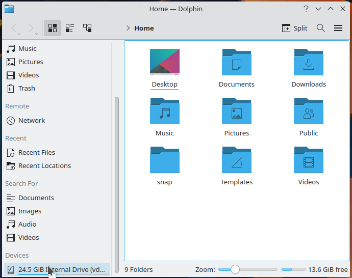

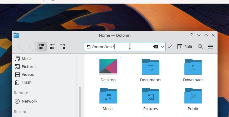

          yes, the main file system is sort of tucked away, and not as clearly labelled as it could be.
          You can get there in two ways.
          One is to click on the location area at the top, and enter '/', or clear the text to get there. or type in the full path you want to go to.

          Another is to click the appropriate drive on the sidebar
          Click image for larger version  Name:	Screenshot_20230319_081037.png Views:	0 Size:	53.2 KB ID:	669229
          Then you can see the whole file system, and browse the to desired location.
          Click image for larger version  Name:	Screenshot_20230319_081625.png Views:	0 Size:	25.6 KB ID:	669230
