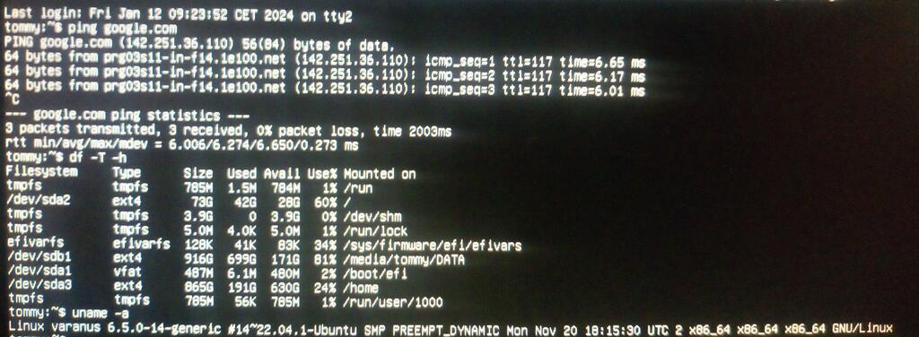

    After a regular reboot, my Kubuntu 22.04 laptop cannot start KDE. I simply cannot understand the messages from in the screen, so I am posting a couple of pictures taken with my phone. I am able to log in on a tty and with the help of a network cable I updated the system (apt update, apt upgrade) and rebooted again to see if the problem solved itself automatically (maybe some critical update was missing?). What can I do to repair my system?

        Try selecting a previous kernel at your grub menu.
        Also, looking at the image, you may want to run a disk check on your /dev/sdb (/media/tommy/DATA)
        I doubt this would stop you from loading the desktop, though, but it will need to be looked at.
          After that, you might try either removing /dev/sdb1 from fstab and rebooting or run fsck on it (unmounted of course). You first screenshot shows an error on that file system. Did you try to shrink that partition?

            I am currently running e2fsk on unmounted /dev/sdb1. It will take some time. There is nothing critical in that partition (it's for temporal storage).
              Im currently running e2fsck on that partition. I haven't done any resize, it's an old disk that i partitioned long ago to store non critical temporary data.
