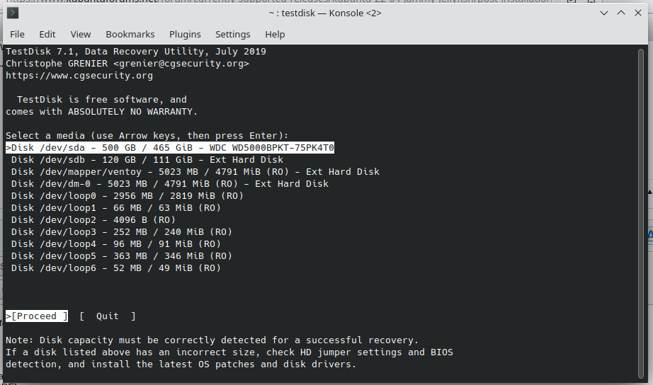

    I'm using testdisk to repair a HD, which is no longer readable, after having wanted to move the rightest partition to the right, and after an error occurred.
    It wrote me that the HD is to small, because there are too many GB and that the problem is concerning the two or three partitions which have the same name HPFS - NTFS.
    I have now the window that you see enclosed and I would be happy if you could help to decide what to do.

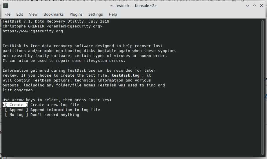

      Thank you Schwarzer Kater for your answer,
      I beg your pardon.
      I wanted to write again
      testdisk
      in a shell, but the screen asked again
      create a log file?
      and I've been afraid that it could interfer with the ongoing process.

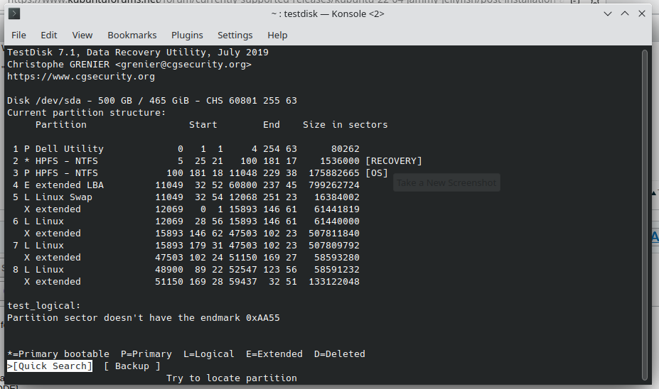

      I now stopped this ongoing process and took screen captures of the testdisks screens:
        This is what follows:
          Thank you very much for viewing.

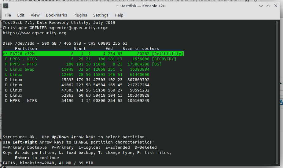

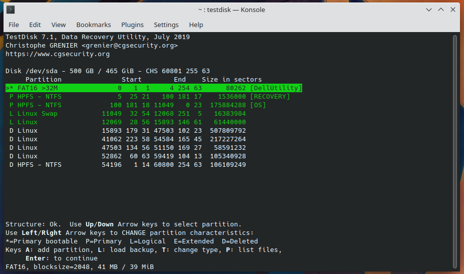

          I've been looking around.
          This is clear:
          The following partition can't be recovered:
          Partition Start End Size in sectors
          > HPFS - NTFS 60800 254 63 67405 253 49 106109249
          In order to save as much partitions as possible, the only following changes are possible
          1)
          1   P FAT16 >32M               0   1  1     4 254 63      80262 [DellUtility]
          2   P HPFS - NTFS              5  25 21   100 181 17    1536000 [RECOVERY]
          3   * HPFS - NTFS            100 181 18 11049   0 23  175884288 [OS]
          4   L Linux Swap           11049  32 54 12068 251  5    16383984
          5   L Linux                12069  28 56 15893 146 61        61440000
          6   D Linux                15893 179 31 47503 102 23    507809792
          7   L Linux                41062 223 58 54584 165 45     217227264
          8   D Linux                47503 134 56 51150 169 27      58591232
          9   D Linux                52862  60 63 59419 104 13     105340928
          10 D HPFS - NTFS      54196   1 14 60800 254 63  106109249
          or
          6   L Linux                15893 179 31 47503 102 23      507809792
          7   D Linux                41062 223 58 54584 165 45     217227264
          8   L Linux                47503 134 56 51150 169 27        58591232
          9   L Linux                52862  60 63 59419 104 13       105340928
          I've been looking the starts and ends of sectors; I choose the second one; and now I have to restart the computer...

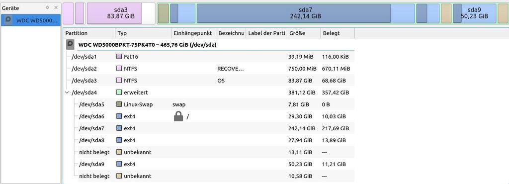

            The partitions are now readable.
            But sda7 cannot start.
            I get the following message:
            error: invalid magic number
            error: you need to load the kernel first
