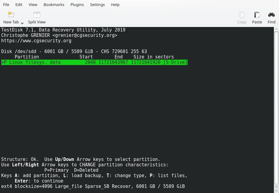

    EDIT 2--- Running testdisk.
    So I've followed the instructions since two websites and one of the kubuntu links pointed to it, I've followed it.
    I've selected the drive
    Analyse
    Quick Search
    and I have this. What do I select please. I am on pause and praying for no power outages.
    A = Add partition - I don't really need pine64 Two-Boot so Nah
    L = Load backup... Hmm Good idea ?? Yes or No
    T = Change type.. Huh WTHeck
    P = List Files... I cannot access them so listing them seams a little redundant, but might be useful if some Kubuntu Experienced person says too
    TIA Kubuntu Forums People.

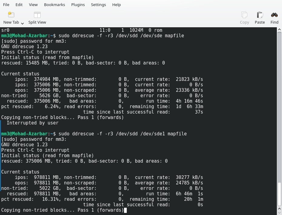

                              take 2 on testdisk. I attempted the create a .img file, but if failed, then I read I should have used "mapfile" as it would have allowed me to get the remaining 4%. I have currently tried these, in an attempt to see what files testdisk recovers. so far, nada.
Name:	230830 - ddrescue what am I doing wrong.jpg
                              16 % completed and still nothing written to my external sde1 disk.
                              So as the file name suggests, what am I doing. wrong
                              Oh! Thanks to Qqmike for his book on ddrescure. I've read through 25% and it just confuses the heck out of me. 90% of what I've read your using if=zero or in other words WIPING the disk. haven't found a single section of actual "data recovery", which is what ddresuce was originally created for. But still thanks.
