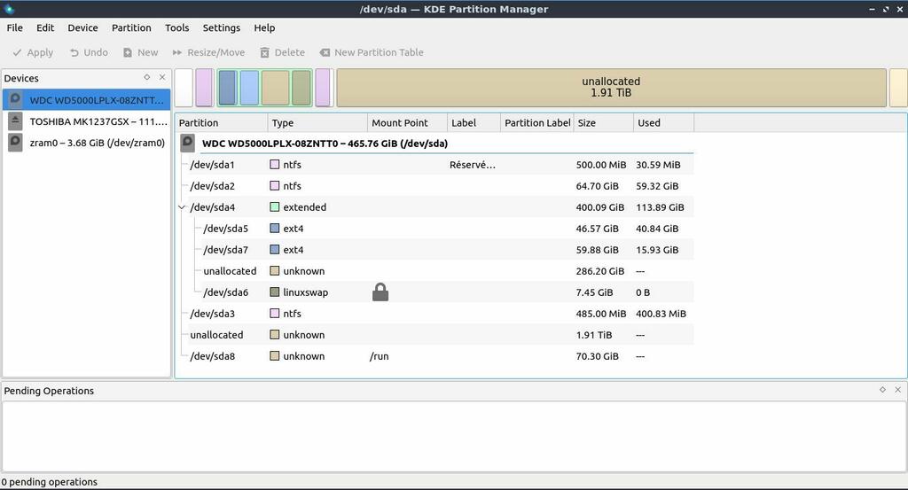

    Dear All,
    I had Windows 10, Kubuntu 20, Kubuntu 22 and Lubuntu.
    As the size for Lubuntu was too small, I reduced the size of Kubuntu 22 (from the right) and I began to increase the size of Lubuntu (from the left). But suddenly the increase stopped and there are only Windows 10 and Kubuntu 20 left.
    Could you please help me to recover Kubuntu 22? The lost of Lubuntu don't heart me much.

    The program "testdisk" may be able to recover your partition table but if you started moving data, it's likely trashed or at least some of it.
    The program "photorec" can recover files and does a good job of it, but won't have filenames so you'll have many, many hours going through the recovered files.
    You're probably better off restoring from a backup. I would never mess with partitioning without a recent backup.
    So based on your description, IF the Kubuntu 22 partition size change completed successfully prior to the "crash", test disk MAY be able to simply recreate the partition table and you're good to go.
    If not, you may be stuck with many hours of file recovery. You'll need enough free storage on another drive to use photorec.
    It's clear from your screenshot that you are still using MBR partitioning. Had you been using GPT partitioning, you would have a backup partition table. That's one of the advantages of GPT partitioning.
    For future reference: It is fairly simple to make a partition table backup. I think I wrote a How-To about that on here like a decade ago or more.
    One positive thing to note is if the issue is only the partition table - it can be rebuilt without deleting data.
    I wish you luck.

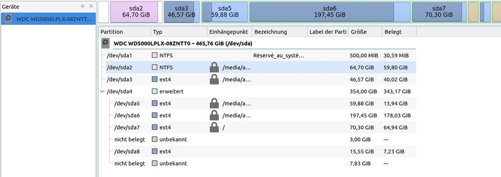

            Hello oshunluvr and Schwarzer Kater,
            Thank you for your answers.
            I used testdisk without changing anything on the proposition of partitions and when I turn on the computer, I don't have any choice of system (I had previously the choice of systems, though only two systems booted).
            This time Lubuntu boots directly and I have access to the files of Kubuntu 20 and Kubuntu 22.
            I can save all files and keep on looking for a way to boot with Kubuntu 22. If I'm successful, I would be after looking on how to boot with Windows 10.

              Partitions after the use of testdisk.
              There is no langer any swap.
                My goal in your situation would simply be data recovery first and foremost.
                If and when I were able to revover all my data (ideally everything were in my backups, of course), I would wipe the disk (GPT this time), install everything from scratch (Windows first!) and copy my data back - because I would not trust the integrity of a supposedly corrupt partition table or file system/table any longer/at all!
                And ideally I would have backups of my Linux systems (Timeshift, et al…), probably even of Windows if there was something important in the claws of a Microsoft system…
                (And the whole partition table as oshunluvr mentioned above).
                Just my two cents and an "ideal" scenario. I am holding thumbs for you.

                    I still don't have any swap. It might be because I had to unmount the swap of the original partition in order to increase the size of the Lubuntu partition at its left.
                    The swap might be the blue partition at the right of sda7. I'm too afraid of trying to mount it, as everything work fine.

                        I'm planing since today to move this partition sda8 to the far right and then to increase the size of sda7 to 10 GB, which was my initial plan. At the end I'm intending to mount the sda8 and I think that it should become a swap.
