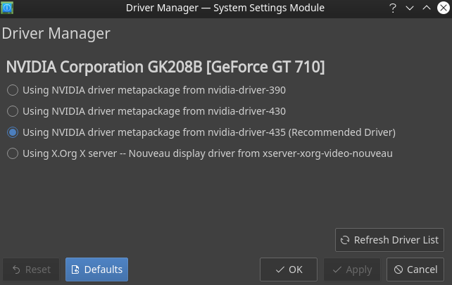

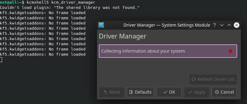

            I type that, I get this:
            Which, after an aeon and a bit - OK, about as long as the other one(s) - produces this:
