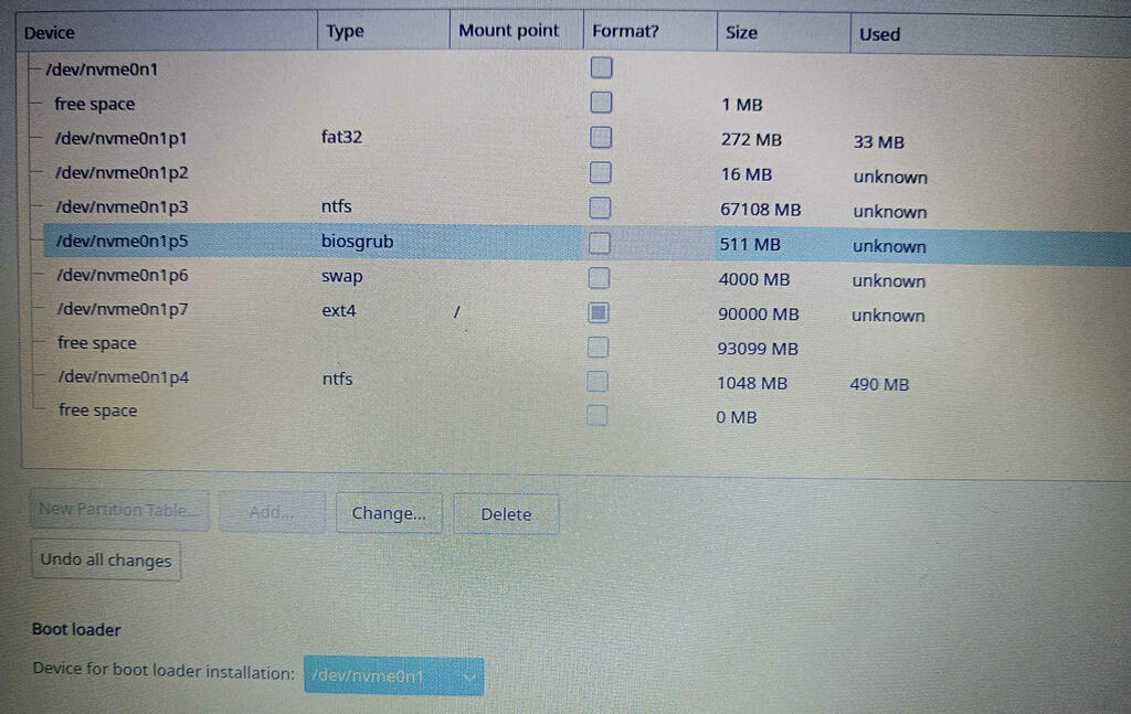

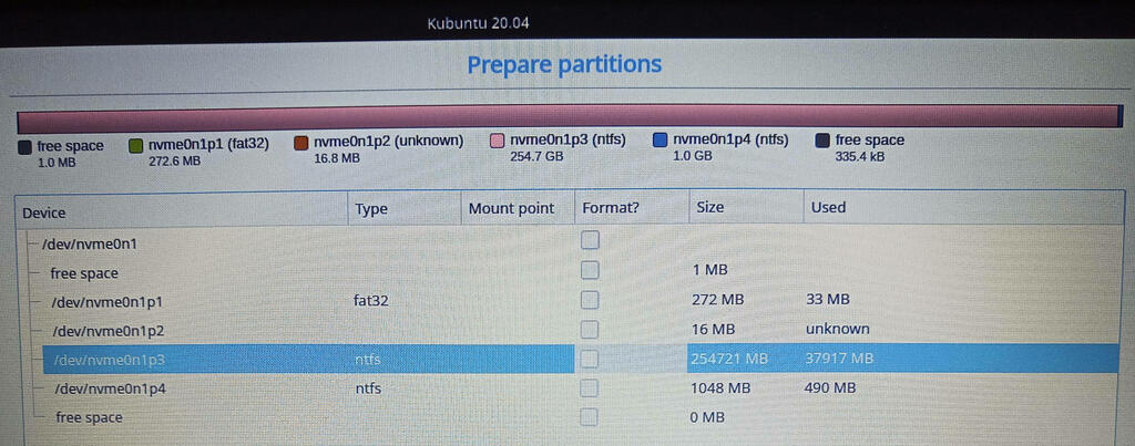

    Drive layout should be attached. Where should the grub go. I've even tried the top one!! Click image for larger version  Name:	OrginalPartitions.jpg Views:	52 Size:	72.3 KB ID:	660477

    Current Partitions and location I attempted to install "Device for boot loader" Click image for larger version
      That biosgrub partition shouldn't be there. That suggests you managed to boot the USB in legacy BIOS mode, but I'm guessing. You don't want that now obsolete mode (though it has its diehard proponents). If you boot the USB in BIOS mode it can only do a BIOS install, and there's no point in not doing a UEFI install.
      I watched the video, and I don't understand why he creates another ESP. The first partition, /dev/nvme0n1p1, is an ESP and Windows and Kubuntu (and whatever) can share it. Grub only needs a few MB of it. "all a GET is windows" suggests that the computer is booting from /dev/nvme0n1p1.
      Unless you know you need a swap partition, I think you don't need it. Ubuntu will use a swap file if it really needs some swap. So I suggest you carefully remove the p5, p6, and p7 partitions and make a single one there for Kubuntu, setting it to be used as "/".

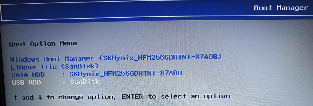

        Yep. I f12 * F8 until I get a boot menu
Name:	Lenovo F12 BootScreen.jpg
        May I assume the linpus lite (sanDisk) is the UEFI.
        Also Thanks Jlittle.
        As You mentioned the Biosgrub shouldn't be there. But I tried everything to get EFI. I just could not find it anywhere.
        As You also mentioned windows is booting off of /dev/nvme0n1p1. On the install disk setup, it Asks, where to put boot installer. Safe to select this partition. I think these is what I selected and got EFI error 10.
        Next. I am using unetbootin, on Linux (PC). The second unused partition is for TO or Qubes or something else I might want to screw around with. I just wanted Windows and Lastest LTS Linux (Kubuntu) to show some Family and friends the security advantages if ditching M$.
        If you Jlittle, have a step by step guide, please feel free to put a link, url or type it out, Please, and another Thanks if you do.
          YaHOOOO! Booted Linpus lite. Looks no different than USB HDD
