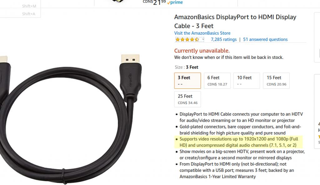

              Originally posted by Modularity View Post
              This dock has a display port on it so I used a DP to HDMI cable to connect the dock to the monitor: https://www.amazon.ca/gp/product/B01...e?ie=UTF8&th=1
              After this change, I am not able to set 2k@144hz res...
              The cable is the bottleneck:
                If the dock has DP, why not use DP? I had to drop my DP connection because my nVidia card failed and using HDMI on the Intel 530 (i7 built-in) I can only get 30hz at QHD+ (3840x1600) even though the monitor supports 75hz
