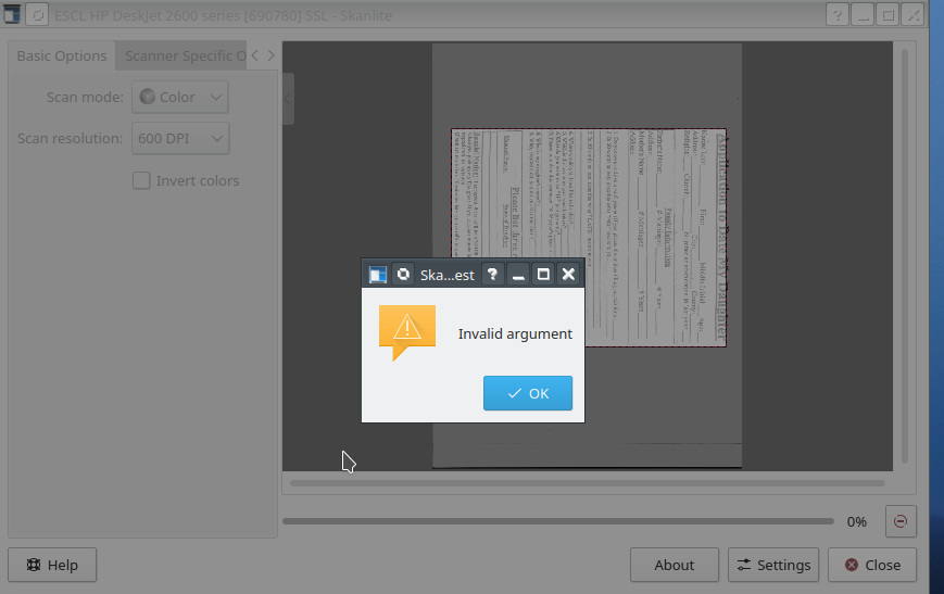

            It looks like it's missing everything. Maybe because it's not plugged into the usb port anymore? I wonder why all of those dependencies are not installed.
            Now when I try to use the scanner I get this because there is no executable in /usr/bin.
            I get the preview but no scan.

                will get worked out. I rarely use the scanner as well but occasionally you get a document that has to be printed and signed then scanned and sent back.
                These dependencies are either incompatible or not in the repos and it won't work without them.
                Missing Required Dependencies
                error: 'libcups2' package is missing/incompatible
                error: 'libusb-1.0.0-dev' package is missing/incompatible
                error: 'libusb-0.1-4' package is missing/incompatible
                error: 'python3-pyqt4' package is missing/incompatible
                error: 'gtk2-engines-pixbuf' package is missing/incompatible
                Anyway, you've been very helpful. THANK YOU much!
