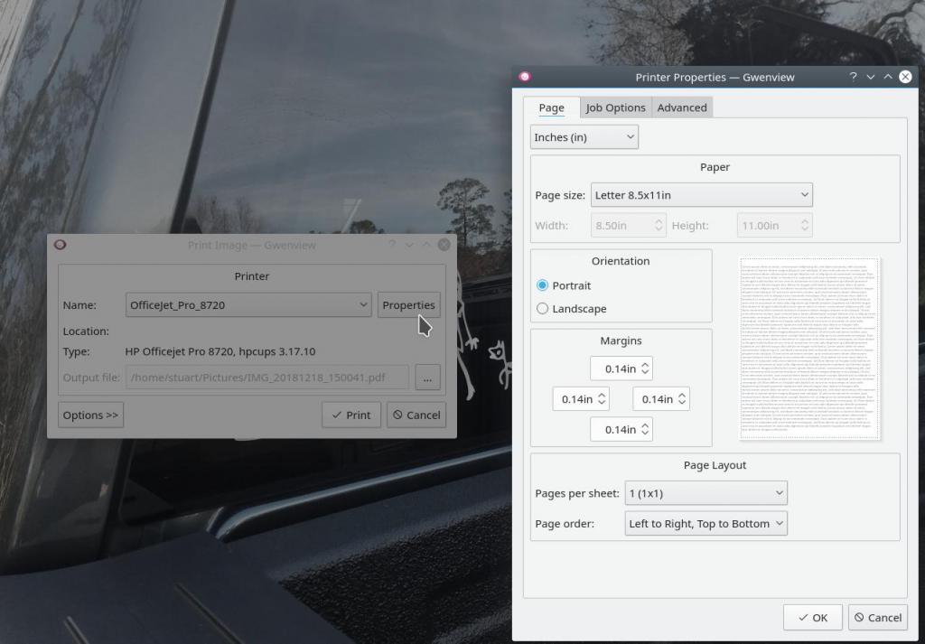

        I have an HP printer and the default paper size is Letter, and that's what I get every time I open "Print" from Gwenview. I don't think the problem is with Gwenview.
          Just checked print to PDF and it's set at A4 when using Gwenview. Curious.

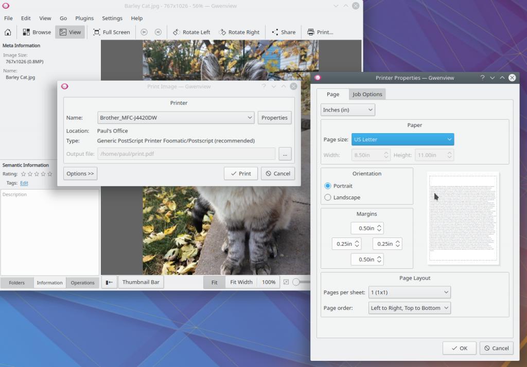

                        I just installed my Brother MFC-J4420DW printer. I don't have the problem being described. The printer is identified by default in Gwenview, and when I click on the Properties button I can select the paper size I want.
                          When you go to print in Gwenview, you don't have the Properties button to click on?
