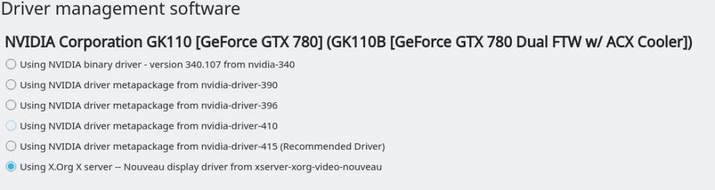

                    set the 415 driver and rebooted. System Settings > Driver Manager shows this:

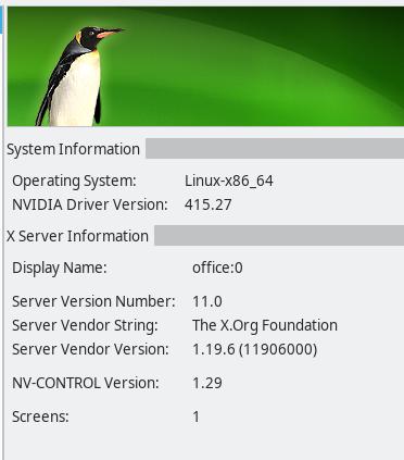

                    but nVidia Settings shows:
                    I confirmed the nVidia driver is in use and the Nouveau driver was unloaded in Xorg.0.log. Further, I have desktop effects in use and they appear normal.
                    The problem appears to be in System Settings or the Driver Manager.
