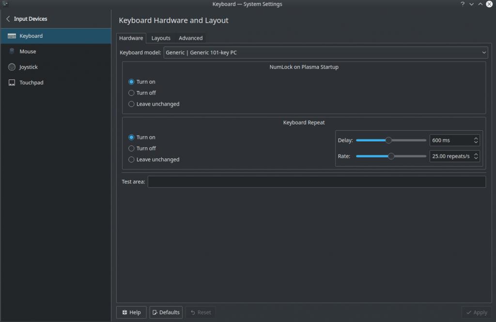

    How can I set Number Lock to stay locked. Don't like resetting it every time I log in?

                  Hey guys, I've been poking around and got some good stuff done. One thing I would love to do is, make the Document Icons in Dolphin a different color...if possible. They aren't to bad, but all that Purple is a little distracting. Maybe I'll come to like it, but would like to be able to change it for now to see if it will be better.
