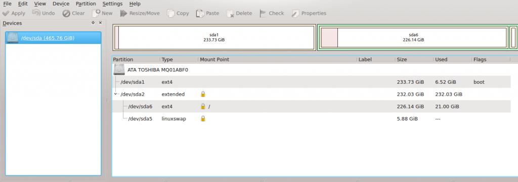

      The other strange thing is when I installed I had the installer use the whole drive. It created the root partition with /home in it with mount point root, a swap partition and another large partition with all the same files as root but no home and designated boot
        What you have looks a little weird, yeah. Was this a completely blank drive when you started? I don't understand why the installer would have made this kind of partitioning decision. You have a 234 GB primary partition and a 232 GB extended partition. Inside this extended partition are two logical partitions. One contains your root file system and the other is swap. And did I read you correctly -- /dev/sda1 and /dev/sda6 contain the same files? Because in your output, they show different amounts of space used.
          They appear to have the same root file system, but home is not in /dev/sda1. I did not check every directory but it is populated with root files. As far as the Intel driver I have no problem with it and generally use the laptop connected to the power source. I have tried Bumblebee in the past, and now how to use it. Each application has to be started with the optirun prefix. I will try blacklisting the Nouveau driver. The main issues for me are the recovery boot, a minor annoyance, and the wasted drive space.
          I may blow the system away and pre-partition with root, home and swap and install manually.
            May I recommend that you just go ahead and do that? I'm increasingly of the opinion that the Ubiquity installer is just no good. It really isn't a Kubuntu thing anyway; it's all code inherited from Ubuntu. The Kubuntu version just implements it in Qt rather than Gtk.
              I will do that and keep you posted.

                        Thanks Steve. Everything is working quite well except for the odd partitioning. The only other issue is with the Intel graphics OpenGL cannot be used. Not a big deal for me. It is odd because on my older Optimus laptop the i915 driver, I guess it is a mesa driver, did support OpenGL. For a while that is. Updates killed that along the way at some time as will.
