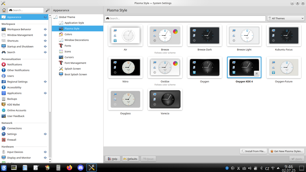

    I've noticed that when i change the Plasma Style in the Kubuntu settings

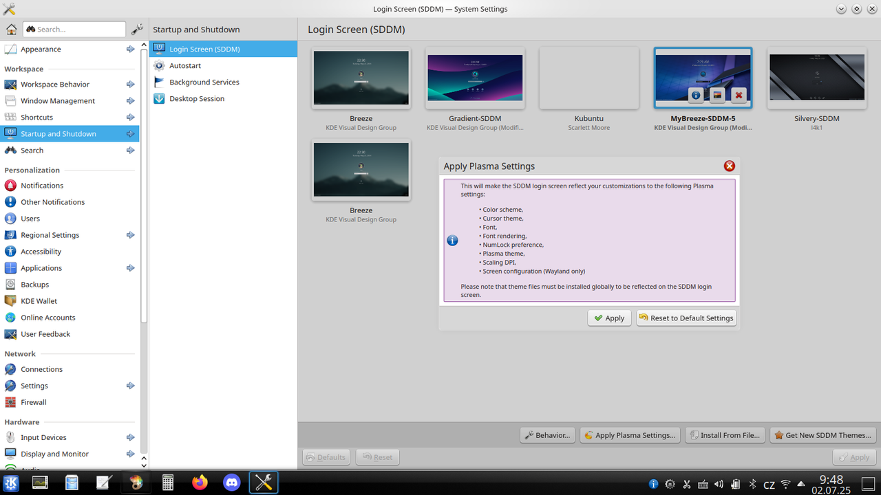

    and then click "Apply Plasma Settings" in the SDDM settings

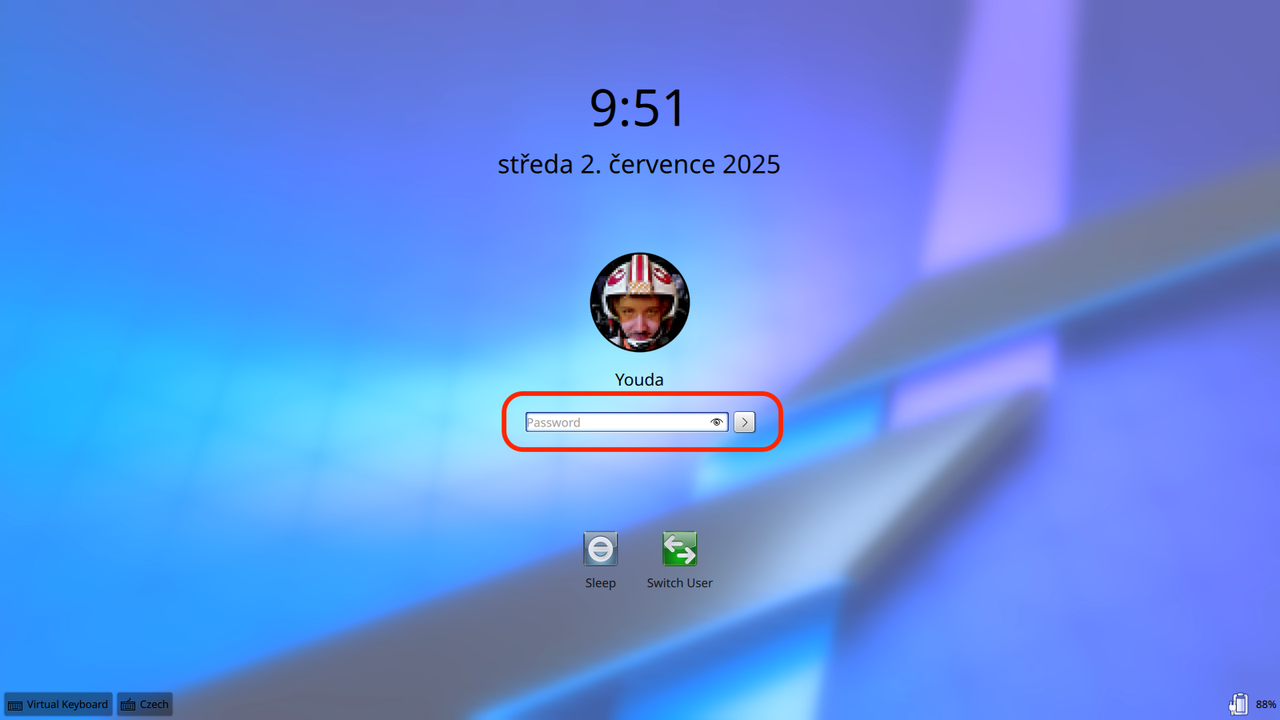

    then it has an effect on how the password line and button looks like
    However when i go to /etc/sddm.conf.d/, there is no such setting. The kde_settings.conf only contains the [Theme] Current= (which controls the overall layout and background image), but not the Plasma Style, which controls the line and buttons.
    Also the UI says it applies the Scaling DPI, which also isn't set anywhere, and imho it doesn't work at all.
    That screenshot is the lock screen (kscreenlocker), not sddm. They intentionally look very similar but they are not actually the same thing, and neither are their configs.
      I know. Because i can't make a screenshot when i'm not logged in. But what i say applies also to the initial login screen. I can give you a photo from a phone, if that's what you prefer.
