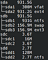

    Running
    lsblk -o name,size,fstype
    I can see sdc is missing the type.
    Click image for larger version  Name:	image.png Views:	0 Size:	13.7 KB ID:	687003​
    Question - is this recoverable within a Linux environment or am I better rebuilding the device back with the original Win10 c: drive and changing the storage drive in there?

      I seriously doubt you need to mess with the partition type.
      1. This
        sudo mount /sdc2 /mnt/Movies2
        is incorrect. It would need to be this:
        sudo mount /dev/sdc2 /mnt/Movies2
        Note the added "/dev" in front of /sdc2.
      2. If this still doesn't work, run "ntfsfix" on /dev/sdc2
      3. If you still have Windows, boot to it and run Windows chkdsk on that file system.
      4. If 1,2 and 3 fail. You may need to dig deeper..
      EDIT: You also need to verify that the file system is not encrypted. If it is, that would explain why KDE Partition Manager says it's unknown.
        Another thing that can cause this is shutting down Windows with fast start enabled.
          I will say that "Microsoft Storage Spaces" is a new one for me. Usually its "Microsoft basic data" but maybe the former is for non-bootable ntfs file systems while the latter is for the OS file systems
            Looks like I can't convert a Microsoft Storage Pool (even if it's linked to just one physical drive) without losing the data so I've found a spare 4Tb drive and spent hours letting it copy over. I've not tried it in Kubutu yet but as it is now a regular NTFS drive like the rest I'm expecting that will have fixed the issue.
