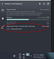

      But you can toggle this off/on from the battery or Power Management icon in your system tray if it is acting up.

                          does the power management widget show that firefox is playing a video? when i play a video in mine it shows up there as an item that is preventing sleep and screen lock
