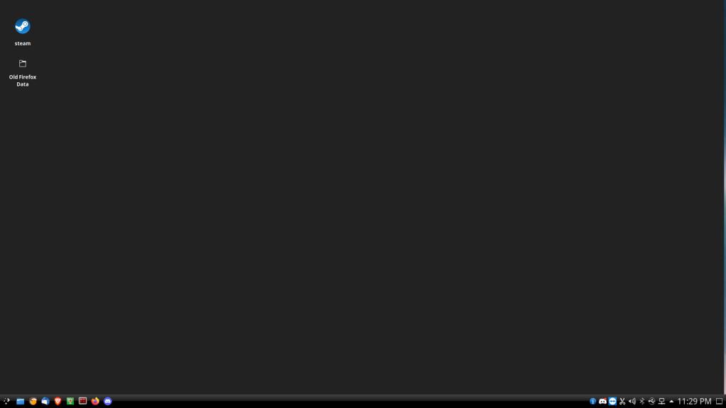

    Not sure what other specs, or settings info you need for this. Basically, on login, nearly my entire desktop background, and it's widgets are covered by a gray panel, with my icons still displayed in their normal locations. This panel cannot be moved, or resized, (despite resizing cursors appearing at the edges), but I can right click it, and manipulate it, like the desktop (New folders, panels, etc).
    On the far right side of the screen, I can see a small sliver of the desktop background. If i click directly on that, the panel in question vanishes, displaying my desktop, and the widget I keep there (A resource monitor). In 4k, this sliver goes along the right side, and the bottom, just above the task manager.

    Can you grab a screenshot of this?

      Here's the screenshot you asked for (taken yesterday)

        Can't really see it here, but I assume that very thin strip on the right margin is the wallpaper? otherwise, it just looks like a b;lank desktop with no background image or color. But the limitations of screenshot may be making this look more black than grey.

          the screenshot captures it perfectly. you see exactly what I see. the black that you see is the gray panel, and the thin strip on the right is the only visible part of the wallpaper. Making the desktop appear requires me to click that strip. I can right click the panel, and choose to show, or hide the desktop.
