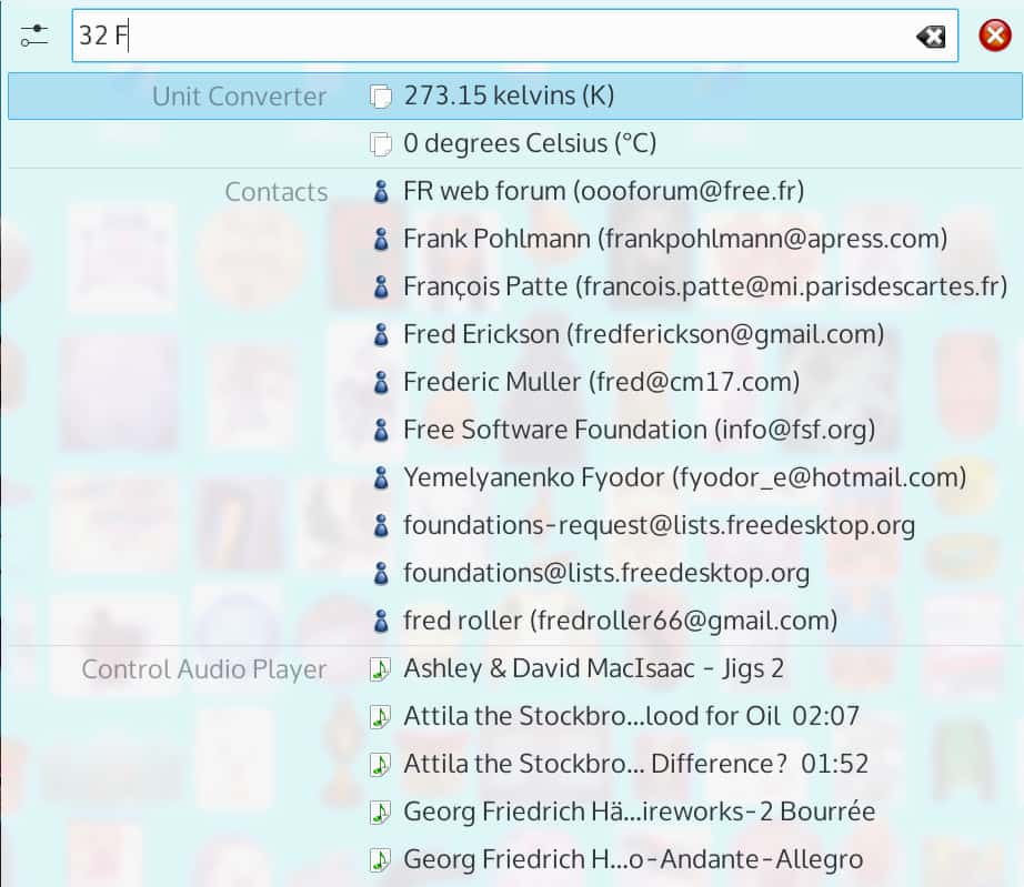

I can't get this to work
In settings for Krunner the unit conversion is ticked as working.
But when I type the 32F temperature I get an email address in Kmail.

Originally posted by jlittle View PostIf I type 200c, krunner gives me 200 times the speed of light in a vacuum, in Mach at standard temperature an d pressure at sea level. Absolutely irrelevant to anyone.
