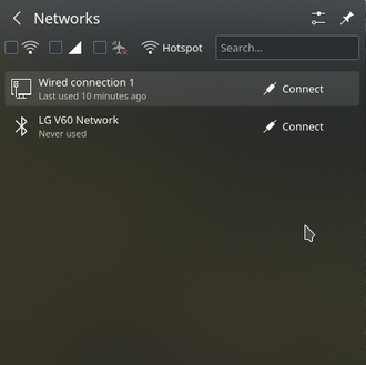

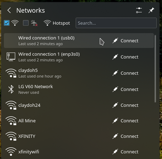

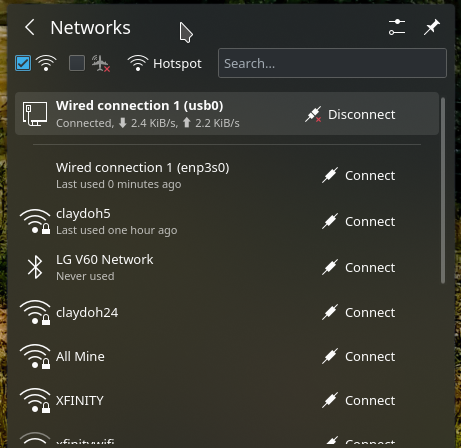

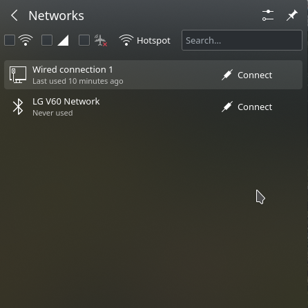

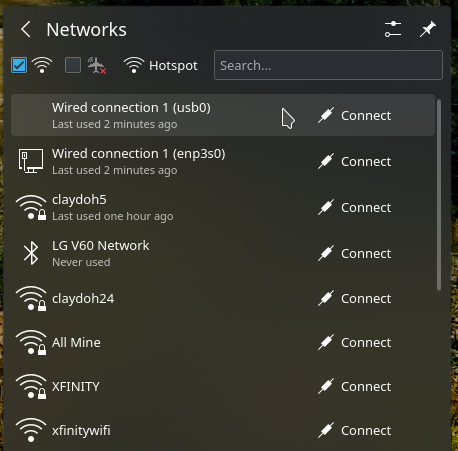

                            Originally posted by Michaeleric View Post
                            The desktop shows connection under "connection editor", but not under "networks", so it seems to be an os issue, and not a phone issue.
                            Mine is the same, but the connection is working. As I am composing this while connected.
                            It is odd, the connection appears, I connect, but then then it disappears from the applet.
ID:	660425 ​​ Click image for larger version
ID:	660424 Click image for larger version
