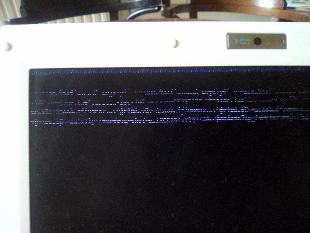

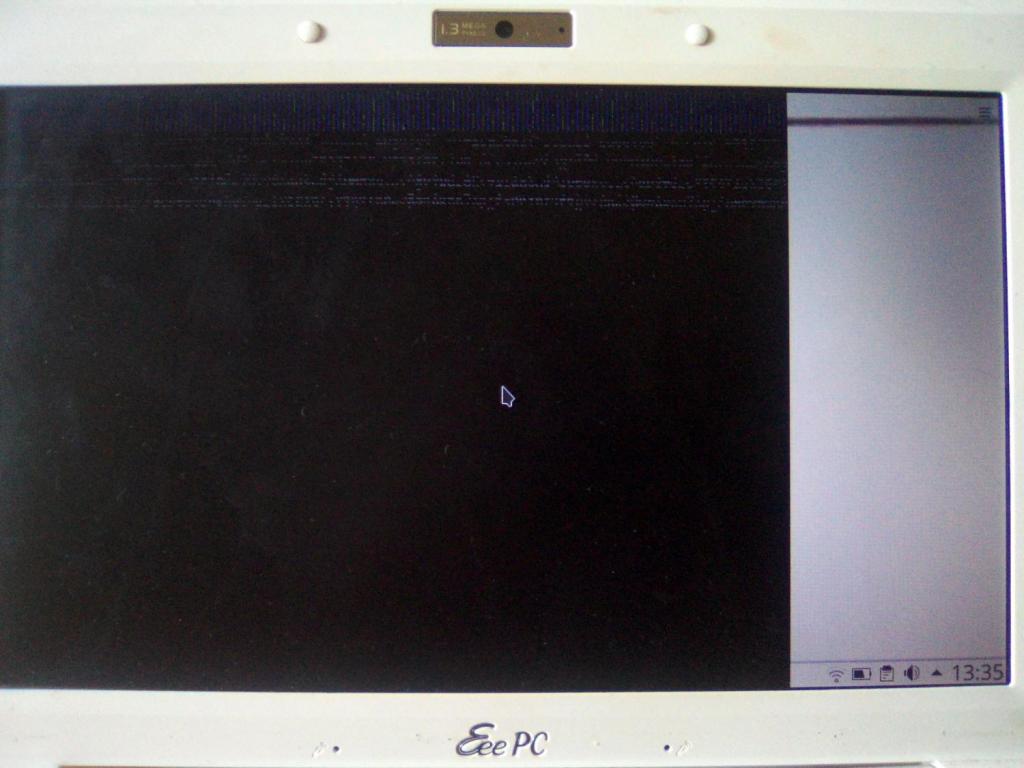

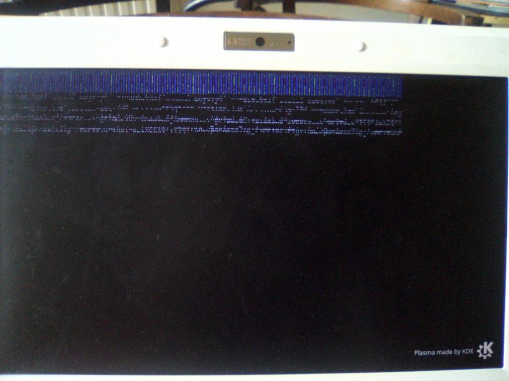

                      I've attached some pictures so you can see the problem yourself.
                      Picture one is plymouth.
                      Picture two is the splashscreen of plasma
                      Picture three is when the system is up (notice the mouse in the middle)
                        It almost looks like your system is trying to display two monitors. I've seen this before where a single video card had multiple outputs and the driver tried to output to both outputs. The video card - sensing only a single monitor - overlayed the two "screens" on the one monitor.
                        With the black screen up, can you get the output of "xrandr" ? You should only see "Screen 0" and one "Connected" line in it's output.
