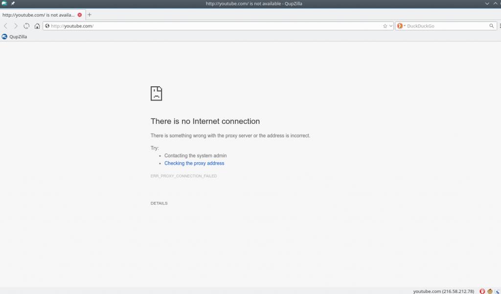

        I don't know what Ubuntu has or doesn't. Plus, I've enabled kubuntu backports. With AppImage v. 2.1.1 I can access the internet as the image shows.
        Again, the point of using the AppImage is that concerns about what the OS supplies do not arise. I agree that not having the required engine in the repos, makes it impossible to provide the browser the regular way.

            Well colour me confused then because all I get is the above error message and if the appimage works fine then the dev's advice needs updating.

                      I just typed youtube.com, I can't remember the last time there when the first part of the address didn't get autofilled. Anyway, it doesn't matter what prefix is typed, it doesn't connect to anything on the net.

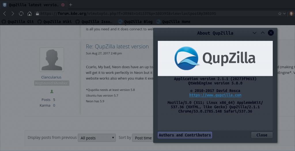

                            Typing just youtube.com works for me: Qupzilla 2.1.1.2 (AppImage).
                            Application version 2.1.2
                            QtWebEngine version 5.8.0
                            © 2010-2017 David Rosca
                            https://www.qupzilla.com
                            Mozilla/5.0 (X11; Linux x86_64) AppleWebKit/537.36 (KHTML, like Gecko) QupZilla/2.1.2 Chrome/53.0.2785.148 Safari/537.36

                              Turns out I just needed to delete the qupzilla folder in the /home/.config/ folder.
