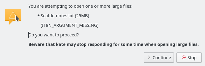

            Yes the file size is 25 MB. I opened it using kate, see the screen shot -- kate says it is a big file!
            At the bottom, using kate, the cursor movement is as described above -- 14.04 was OK, 16.04 sucks.

              The error msg says "i18n" missing. That stands for "Internationalization", there being 18 letters between the first "i" and the last "n" in that word.
              There should be as default installations on your machine the following libraries which will give you i18n capability:
              debconf-i18n
              libkf5declarative5
              libkf5declarative-data
              Also, make sure that the following are also installed on your system.
              language-pack-en
              language-pack-en-base
              Also, for text files, make sure that Tools --> Encoding --> Unicode --> UTF8 is set, unless you are not using English. Then UTF-16.
                You are attempting to open one or more large files:
