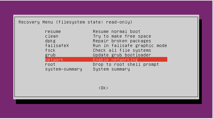

    You can also boot into recovery mode and activate network (a cable network connection required) and then drop to root and type the command there, restart with Ctrl + Alt + Del!

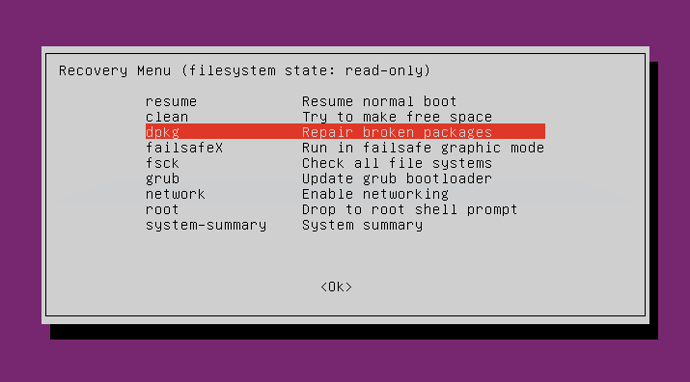

    Another recovery method would be to run "dpkg":
