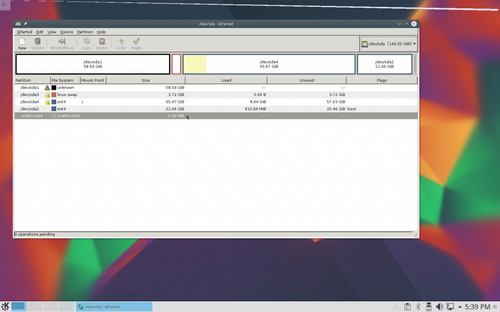

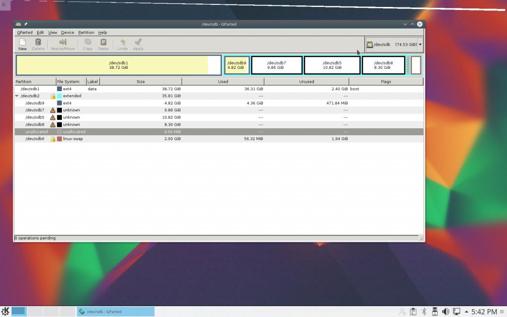

              I took a picture of each of my two hard drives but I cannot get dropbox to work. What is the easiest way to send them. (Consider that I am not to swift to day. I am 84 and have good and bad days.
              (Images posted by Snowhog)
                Can you save the pictures to your hard drive as either a .jpg or .png image? If 'yes', then you can attach them to a post here. If 'no', then you can, if you want, email them to me:
                snowhog @ kubuntuforums . net
                (remove the spaces of course)

                    To check changing the partitions I sent in the pictures should I start a new thread? I think I have them set wrong. I did not really know what i was doing when I installed the Kubuntu. Plasma still crashes every 10minutes or so.

                      Don't start a new thread, do a clean install. You have two drives, sda and sdb. You have both sdb1 and sda2 with boot flags set. You also have too many partitions created on both drives.
                      Use your larger 150GB drive, sda, as your boot drive and do a fresh install of Kubuntu onto it. During the install phase select sda as the target and let Kubuntu take all of it. (Unless you plan to do a lot of video editing you don't need a swap drive, especially if your RAM is 4GB or larger.) You should be given the option of using the entire drive. Take it. That way you don't have to worry about how much root or home should have. All the space becomes available to which ever needs it at the time. If the grub installation asked where it should be installed choose sda1. Ignore sdb until after the installation is complete. When Kubuntu is up and running after you reboot that's the time to use KDE Partition Manager to reformat sdb. BE CAREFUL to choose sdb. Delete all the existing partions on sdb and create one big partition formated with ext4. Give it a label: /data, or something of your own choosing. Since it is on a separate device you could call it /backup and use it to back up your home account. Just a suggestion.
