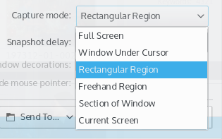

    Ksnapshot has a "Window under cursor" option in it's drop down list so it looks like it may be intentional behaviour or third party software not fully updated to work with the newer plasma?

      That option has always been there, and I'm prety sure there use to be, in my case, two extra options for capturing each screen individually.

        Well, here on 15.04 there's a "Full Screen" and a "Current Screen" option. That's not what you're looking for?
          The "current screen" feature is what I'm looking for yes, but the problem is that "Full Screen" and "Current Screen" have the same output. The same happens in skype, hangouts, appear.in.... I can only share the the full desktop accross the 2 screens.
            Once you select Current Screen, click take new snapshot and click on the screen you want to snap.

              Ok, so I can say (I have three monitors) that the "Full Screen" and "Current Screen" snapshots work as expected here. Meaning full screen shows all three monitors but current screen only the screen under the mouse.
              Something has changed in your settings somewhere to cause this. Did you unify the outputs in system settings? What does xrandr show?
                You are absolutly correct, I forgot to take a new snapshot after selecting the current screen option. So that is one mystery solved, but I still have the same issue with every meeting software I try to run.
