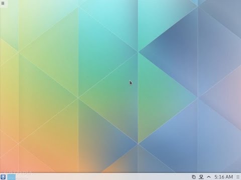

                      For those who cannot install Plasma next or simply don't want to here's a video demonstrating it.
