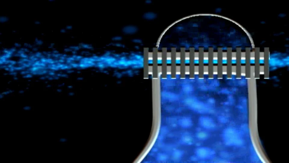

Fairewinds shows that the nuclear industry's plan to vent the containment at Fukushima Daiichi could not have prevented a containment failure and the ensuing explosions. Look at the graphics from the containment stress tests conducted more than 40 years ago at a US nuclear reactor identical to Fukushima Daiichi Unit 1. This video and its graphics provide important clues about why Fukushima Daiichi Unit 1 exploded.
To my way of thinking, the data does not support the interpretation of the nuclear industry and the Japanese. What the data does support is the Brunswick test from 40 years ago. It seems to me that for 8 hours or more, the containment at Fukushima was basically ruptured, that the top had popped up, and gasses were sliding out, so that it could not go over 100 pounds per square inch.
And hydrogen gasses were leaking out of the containment and into the reactor building for a long period of time. After that, it only took a spark to blow the reactor building up. This is a really important distinction. The nuclear industry, the Nuclear Regulatory Commission and the Japanese are saying that we can make the vent stronger so that this accident cannot happen. But if the nuclear head is lifting up, the vent is irrelevant. The containment on the Mark I design has a design flaw that the containment vent cannot solve.
