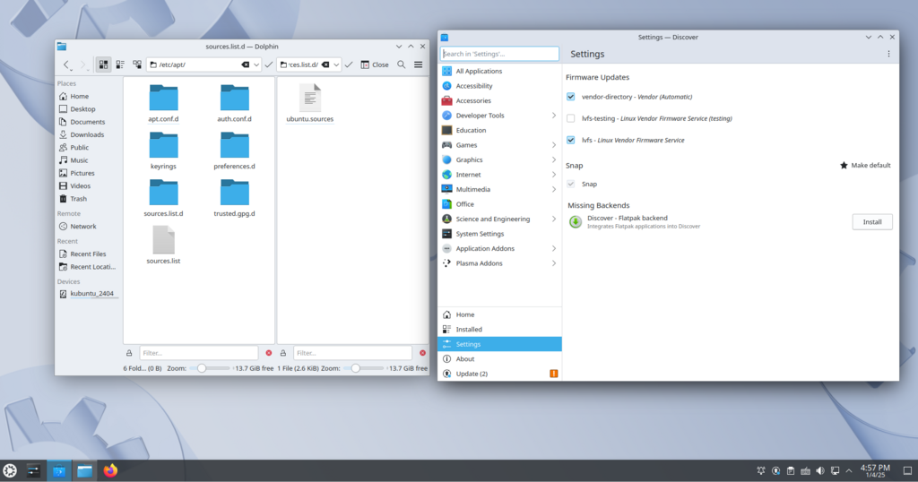

        What is interesting/confusing is that in 24.04, which uses KDE Plasma 5.27.12, also uses the new deb822 sources format, but there, Discover Software Center does see/use the /etc/apt/sources.list.d/ubuntu.sources file. But not so in 24.10. Why?

                            Added:
                            It sure doesn't for me.
                              Well damn! I just checked on my 24.04 installation, and (now) Discover Software Center doesn't have access to Software Sources. I swear I saw it when I made the post.
