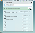

          Captive portals can be messy, especially ones that use an oddball config or something a little bit non-standard.
          I know it works on Plasma 6.2, as I used it a few weeks back, had a notification like this:
          This caused a small web window to open with the login page of the portal.
          It *should* be in 6.1 as well, iirc.
          In can't recall how it worked in Plasma 5.
          But using https-only features (Firefox) can muck with these as can using VPNs and custom DNS stuff
          Sometimes going to an http-only website such as http://httpforever.com​ can trigger the captive portal to open (as they often aren't using https since they are local and not internet-facing)
