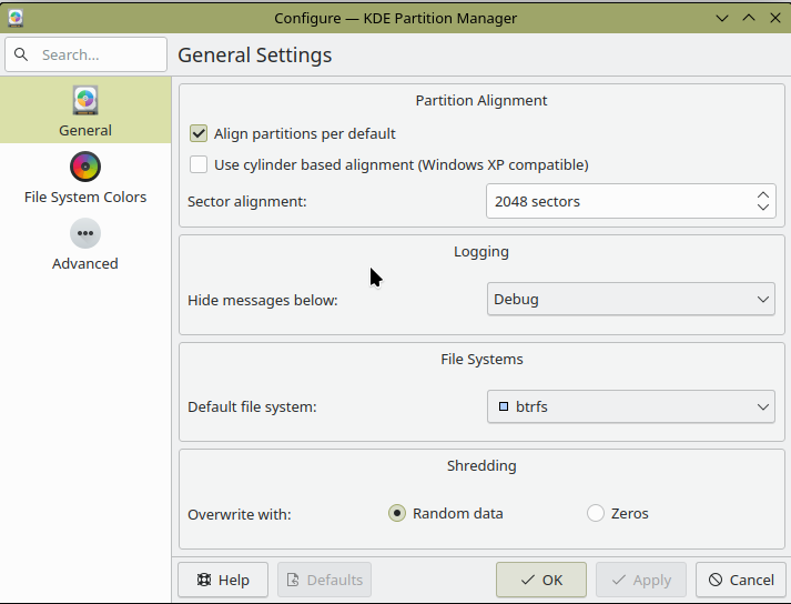

          I *think* that the 1Mb can come from the GPT needing a small amount of empty space, and the leftover either rounds up or the alignment is different enough to make up 1Mb.
          Not sure if any settings affect this

                    Maybe I was wrong. This from a Kubuntu 24.04 VM:
                    Number Start (sector) End (sector) Size Code Name
                    1 2048 4095 1024.0 KiB EF02
                    2 4096 1054719 513.0 MiB EF00 EFI System Partition
                    3 1054720 62912511 29.5 GiB 8300
                      Meaning that I DO need that empty, unknown 1 Mb partition? If we are all agreed that I do need that mini partition, that brings me back to my original question: using KDE Partition Manager, how do I create it? I've done it quite a number of times before, but I'm missing something now because I don't see how to do it. If I click New (partition), then make it unformatted, I don't see how to reduce the size to 1 Mb. I've already established the GPT for the entire disk.
