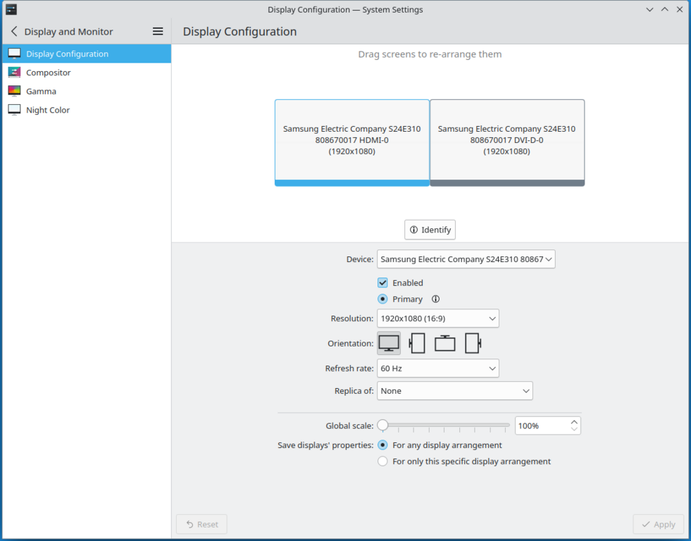

      It 'sounds' as if you have the second display setup/configured to be an extension of the primary Desktop. What do you see in System Settings > Display and Monitor > Display Configuration.
        Hi, thanks for the quick feedback! Here's a screenshot of my Display Configuration. The interesting thing is, the screen with the black background is the Primary.

          Unless you are mirroring the Displays, backgrounds are configured for each display.
            OK. I launch the Desktop and Wallpaper configuration menu, and it only gives me one choice for what wallpaper to set, and it only appears on the screen on the right. I have no right-click context menu on the left (primary) screen, but when I do Alt-D Alt-S, I get the same dialog, and any changes only affect the screen on the right. Do you have any suggestions for what I should look at next?
