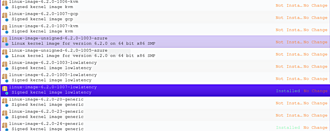

      Click image for larger version  Name:	1007-low.png Views:	0 Size:	147.6 KB ID:	671933
      Used Muon and found this: I have 6.2.0.24 installed so I can remove the 1007-low-latency?
        Only if you are booted with the 6.2.0.24 kernel.

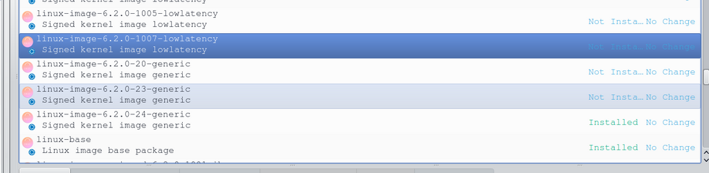

            Just one more thing. Why would it want to install 1007-low-latency when I'm trying to remove it?
            I see one is unsigned and the one I want to remove is for nvidia, but I don't understand. I also don't see an "unsigned" version in the list above.
            I thought I should check before proceeding. Thanks.

              A dependency bug in some Ubuntu package, probably related to Nvidia drivers. Plus often an unsigned one needs to be replaced with the signed by version, and vice versa. The bug is prob compounding this one
              Which kernel are you booted to currently?
                Currently booted to 6.2.0-24-generic

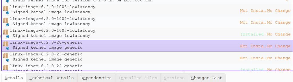

                I went ahead removed the lowlatency and this the result so far:
                ╰─ apt search linux-image | grep installed ─╯
                WARNING: apt does not have a stable CLI interface. Use with caution in scripts.
                alsa-base/lunar,lunar,now 1.0.25+dfsg-0ubuntu7 all [installed,automatic]
                linux-image-6.2.0-24-generic/lunar-updates,lunar-security,now 6.2.0-24.24 amd64 [installed,automatic]
                linux-image-generic/lunar-updates,lunar-security,now 6.2.0.24.24 amd64 [installed,automatic]
                Linux-image-unsigned-6.2.0-1007-lowlatency/lunar-updates,lunar-security,now 6.2.0-1007.7 amd64 [installed,auto-removable]
                So now the system restarts without hanging but I'm left with the "unsigned" version. Should I 'auto-remove' it?
                This is partial Muon listing:
                In any event, thanks for responding
