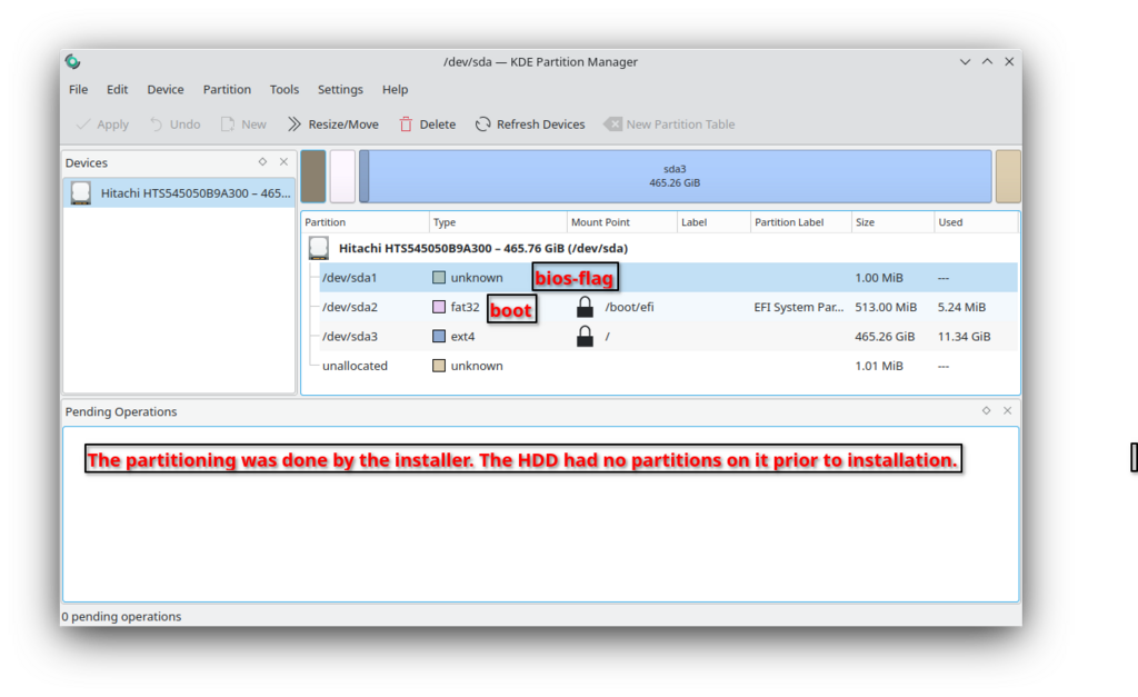

                    9. Launched KDE Partition Manager to see how the installer setup the HDD
                    The picture below contains annotations as to the flags, if any, were set by the installer on the partitions it created.
Name:	Kubuntu 22.10 Installation Partitioning Created by the Installer.png
                    So I now have a working (again) Kubuntu 22.10 on my laptop, but with a single ext4 partition for Kubuntu 22.10. The installer created the 1.00 MiB /dev/sda1 partition with no filesystem type, but with the bios-flag set. It created /dev/sda2 with filesystem type fat32 and with the boot flag set.
                    As I want to use btrfs, but using the Manual option in the installer to setup the HDD constantly fails to install GRUB, I'm wondering if I can use the information gained and redo the installation, select Manual, and use the existing partitions, but changing only /dev/sda3 to reflect btrfs and proceed. Will the installer successfully install GRUB then?
                      I'm about to find out.
                      Rebooted the LiveUSB of 22.10. Selected to install Kubuntu. Selected Manual and changed /dev/sda3 to btrfs. Made no other changes to the partitions. Left sda as the location to install Grub (?); the drop down selection for the boot loader?
                      Will know shortly if this works. If it fails again, I'll repeat but select sda1, and if that fails, repeat and select sda2. As previously stated, this should not be this complicated!
                        Success!!!
