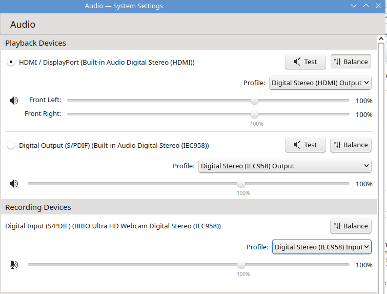

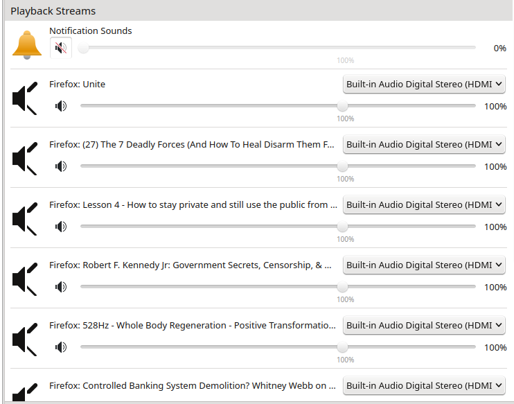

A number of things are wrong, which I mentioned above. First, the volume control on my speaker no longer works; I have only one volume sound. Second, when I try to re-select the default setting in Audio--System Settings, I can't. The Profile button's drop-down menu now doesn't have the full list of options it had to begin with; it has only the entry you suggested and I chose, and off. When I was using the default setting, the main speaker's volume control worked. Let's solve these before any more. And thanks for your continued help. This is really critical for one particular purpose which is only a week away. After that, I may not need this device.

Show us the settings you see, again, if they are different from those in post #11
Those look completely fine, to me.

Though this didn't work before for some reason, tonight merely selecting 'Line out (Built-in audio analog stero)' sent the sound to the speakers. Until I got this to work again, I've been using 'HDMI / Display port (Built-in Audio digital stereo (HDMI))', which sent the sound to the monitor's speakers. That's where I had no volume control. Now I need to learn how to control the monitor's speakers.
The other issue may be solved, not sure. Now the 'Line Out (Built-in Audio Analog Stereo)''s drop-down menu has the entire original options list. But the 'HDMI / DisplayPort (Built-in Audio Digital Stereo (HDMI))'s profile drop-down menu lists only 'Digital Stereo (HDMI) Output' and OFF. Don't know how to get the full menu list in this one if there was one. Claydoh, can you tell me about this?Last edited by RLynwood; Oct 20, 2023, 11:17 PM.
