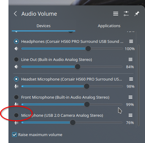

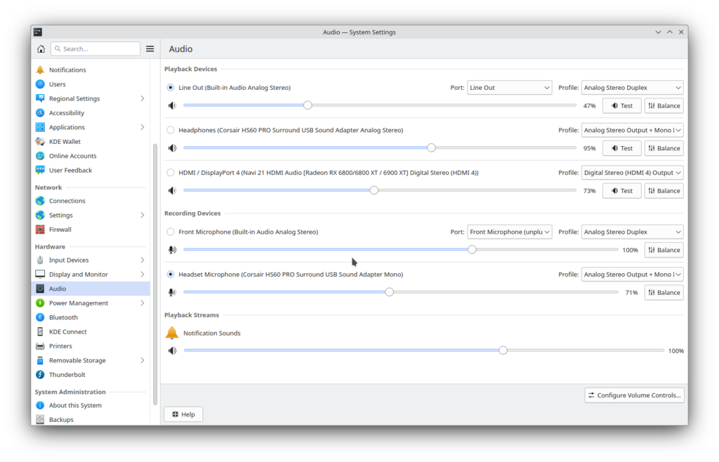

      Does it show in your audio widget and system settings?
ID:	674431 Click image for larger version
      You may gave to select the desired mic as the in-use device.
      A recording app may require you to select a specific device it its settings or similar.

              The audio widget shows it at 60%, and the system settings has it at 100%. And the System Settings identifies the brand and model.
              But is it selected? Note my three mics from the screenshots

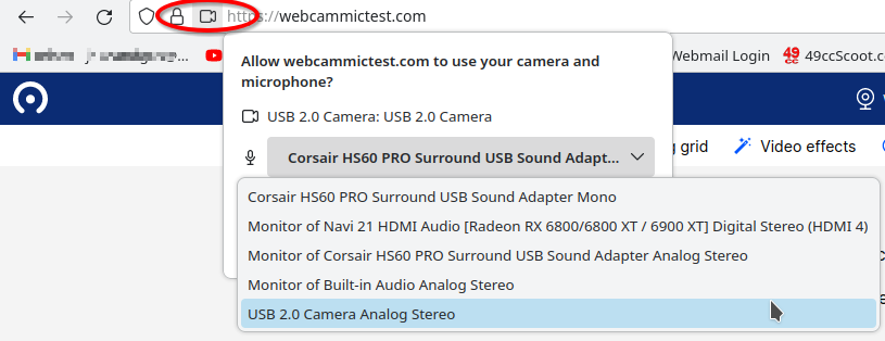

              You may also need to select a specific device, depending on whatever application want to use audio input. if you previosly used a different audio input in the browser, you may need to select a different one:

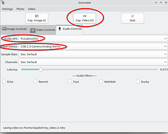

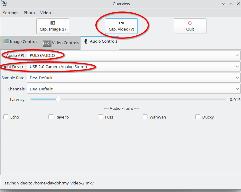

              Try a test with Guvcview, if you haven't already.
              Check the audio settings to select "pulseaudio", select the camera, and hit record video.
              The file will drop in your home dir.
              There are websites for testing webcams that might be useful as well.
              Can you see any movement on the bar when your cam's mic is selected, and you have any noise or speech?

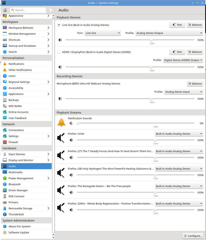

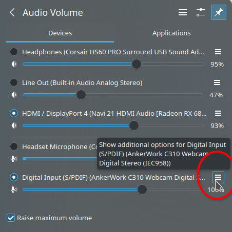

                    I don't understand a number of your screenshots. First, re. your 10-14, 11:37 a.m., post, I don't see those selection buttons on my Audio Volume. It just says "Microphone." I haven't been able to get a screenshot of it because, when I activate Spectacle, the Audo display disappears, and I don't know how to display it apart from clicking it in the system tray. And in the Audio--System Settimgs > Audio panel, there is no selection button. I'll stop here before continuing to another item.
                      Open the widget, then click the "pin" icon on the top-right corner, to keep it open.

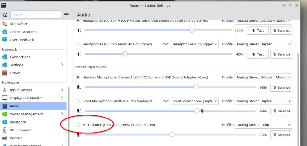

                      we will need a screenshot of that
                      If you only have one microphone attached, there won't be a button to select it, methinks.
                      Click image for larger version  Name:	Screenshot_20231016_141521.png Views:	3 Size:	153.7 KB ID:	674502

                        Click image for larger version  Name:	Screenshot_.png Views:	0 Size:	30.2 KB ID:	674506 Thanks. Here's the Audio Volume
                        I have only the Brio Pro's mic attached, but here's its screenshot
                        Click image for larger version  Name:	Screenshot_2.png Views:	0 Size:	227.9 KB ID:	674507

                          So, if you tap the mic, or speak into it, does the blue volume level bar in the widget react?
                          if so, it is working.

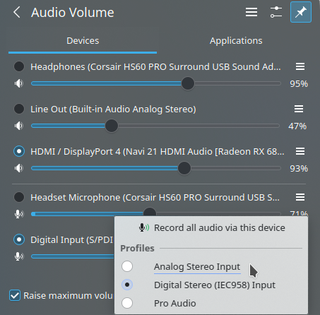

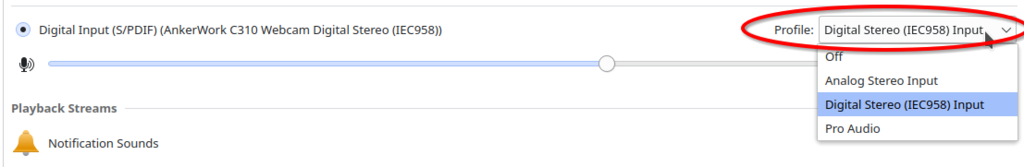

                          Another thing to try, is to switch to a different profile.
                          From System Settings, :
                          Or from the widget itself:
ID:	674519 Click image for larger version
                          This probably won't do much, but who knows.
                          The "pro" option, may not work at all.

                            "Another thing to try, is to switch to a different profile." Given above, what would be the reason to change the profile, and why did you choose 'Digital Stereo (IEC958) Input'?
                            I followed your choice. Before, it was--I can't make it display the option list, including the first one, the default, which was selected before I changed it. It was something like Default audio [something].
                              Because it was there, so I clicked it This is The Way.
                              It is worth trying, though mainly for multichannel sound cards and headphones or Bluetooth earbuds.Usually nothing changes, or the other options do not work.

                                I've just discovered that, now that I've selected the digital stereo output for the Recording Devices, the profile displays ONLY that and off. The original selection list, including the default, no longer gets displayed. That's in both the Audio Volume widget and the Audio--System Settings. Further, the volume control on my (main) speaker doesn't work. In the System Settings Audio panel, selecting the HDMI (Built-in Audio Stereo (HDMI) yields sound output through the speakers but with no volume control.
