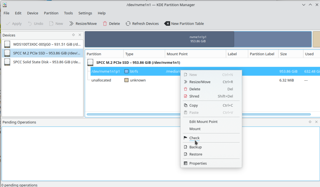

        Gparted, or KDE Partition Manager can do this (via fsck, actually)
        The problem can be doing so on a running mounted file system. You can use a live USB to do this, in this case, as the computer's drives can be unmounted if necessary.

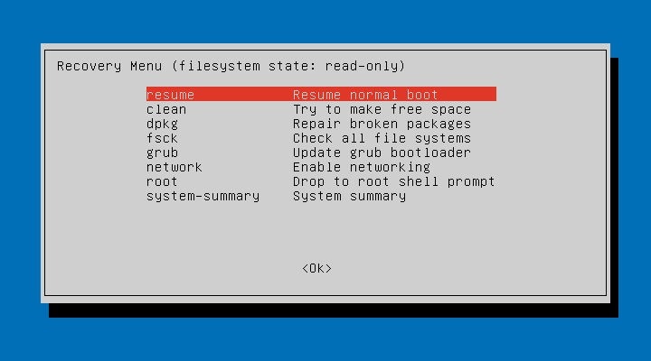

        You can also use the recovery menu to run an fsck, it is an option in its menu.
        This IIRC may mount it in read-only mode, which at least can show problems. I has been a while since I used recovery mode for this.

          When I try to run KDE Partition Manager it starts, but just there and hangs up?
          Greg
          W9WD
            Check that the password box isn't hidden under the main window. I see that happen a lot.
            Or if it is misbehaving for some reason, just use Gparted, I believe it will have the same option for this, though it will likely be in a different spot.
              It was behind the KDE Partition Manager.
