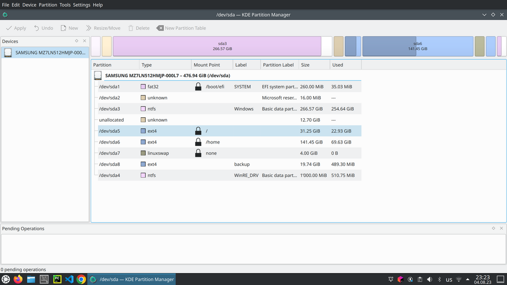

                      I'm attaching here a screen shot of my partitions (this one is taken from my actual current Kubuntu session (the one I will wipe out)). As mentioned in the previous message, only the /dev/sda7 is locked when I use the usb live key.

                          Thanks for your reply GreyGeek. I would do this btrfs set up if I wasn't blocked by this indestructible swap partition. As soon as I'll know how to wipe it out, I'll try out your recommendation.
                          • oshunluvr
                            oshunluvr commented
                            Editing a comment
                            I thought I had said this before, but to reiterate: ANY partition in use will be LOCKED to prevent destruction of a running operating system.
                            Your LiveUSB session detected and mounted the SWAP partition. This is expected.

                          You could e.g. either
                          sudo swapoff /dev/sda7 in the Konsole terminal emulator (also see man swapoff) to temporarily disable it and modify it afterwards (and don't forget to modify your swap entry in /etc/fstab accordingly(!) - to disable it permanently comment out the swap line in /etc/fstab and reboot)
                          or
                          boot from a GParted live USB stick (https://gparted.org/download.php) to be able to modify all of your partitions (be careful with that and have a working backup of the drive's important data on a seperate drive!).
                          Last edited by Schwarzer Kater; Aug 05, 2023, 05:51 AM. Reason: language corrections
                            #74
                            Schwarzer Kater Thanks a lot for your answer. I used the first option and it worked. Now I deleted 4 partitions: root, home, swap, and backup. I started the re-installation of Kubuntu, and I'm at the Disk Setup stage. I chose the "manual" option (all others would delete my windows partition(s)). On top of the window, it's written "Prepare partitions" and one can indeed create new partitions. I have 224'547 MB of "free space" so I guess I will create two partitions, one with around 40GB (40'000 MB), with mount point "/" and one with all the rest, with mount point "/home".

                              Again - a restatement: If you are going to use BTRFS, you do not need and should not have a separate /home partition. If you use EXT4 then you might want a /home partition. Other that that, all looks OK. If you mess with or delete the EFI partition, not only will Kubuntu not install but Windows will no longer boot.
                              In my opinion, you've already had to wipe and reinstall once because you had a root partition that was too small. Why once again potentially subject yourself to the same situation by partitioning and using EXT4 when you can have all your space as one partition? BTRFS will allow your root and home subvolumes to expand and contract as needed all without you doing anything. "Subvolumes" are with BTRFS uses instead of partitioning. The subvolumes all reside on a single partition and share the free space as needed. If you make a separate home partition then you've eliminated half the reason to use BTRFS in the first place.
                              To show you what I mean, here is the output of df on my system minus tempfs and other irrelevant things:
                              stuart@office:~$ df -h
                              Filesystem       Size  Used Avail Use% Mounted on
                              /dev/nvme0n1p3   500G  355G  138G  73% /
                              /dev/nvme0n1p3   500G  355G  138G  73% /subvol
                              /dev/nvme0n1p3   500G  355G  138G  73% /home
                              Notice all these mount points are on the same partition. All show the exact same amount of used and free space - because they are all on the same partition (file system). The /subvol mount is not a subvolume, it's the full partition itself. There is so much used space because there are other subvolumes on that file system that are not mounted and thus don't show up in df output. There other subvolumes are other bootable installations and a snapshots folder where I keep daily snapshots. Here's the contents of /subvol:
