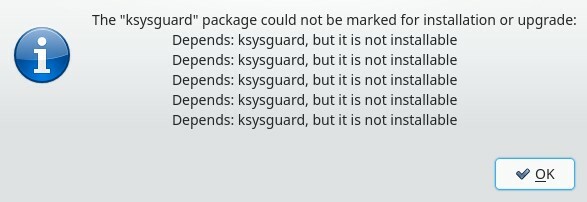

    So after upgrading to 22.04 from 20.04, all my icons were present & accounted for. Earlier Today some program locked up and I was unable to close it. I clicked on the icon for ksysguard to isolate and manually stop the program.
    I encounted an error, program not found (Or words similar)
    I opened muon to install it, and got an error, unable to install, Click image for larger version  Name:	Kubuntu-ksysguard-could-not-be-marked.jpg Views:	47 Size:	27.3 KB ID:	670139

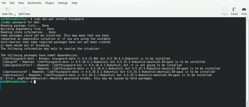

    I tried konsole and got this error
    Click image for larger version  Name:	Kununtu-ksysguard-not-installed.jpg Views:	45 Size:	65.0 KB ID:	670140
    Any Suggestions?

    Ksysguard was removed and replaced with System Monitor.
      Okay. I'll look around for it. Thanks BeerIsLife
        Bummer. I can't find it, or google an install for it. What is the package called please?
          It's called plasma-systemmonitor, both the executable and the package name.
          That would be odd if it's not in a jammy install, it's a standard part of KDE plasma. Is the file /usr/bin/plasma-systemmonitor there?
            As Beerislife wrote: Ksysguard was removed. It was not a decision of Kubuntu to replace it with Plasma-Systemmonitor, but of KDE for the newer Plasma/Gear versions.
            It is not advisable to install Ksysguard in 22.04, because its dependencies are no longer present in the *Ubuntu repositories (e.g. ksysguardd), its dependencies will break others and it is no longer maintained. The only "clean" way to install it in Kubuntu 22.04 would theoretically be in a containerized solution like distrobox (with 20.04).
              Yep !!!. It's in MUON, after I search for the correct name... Oh. It was installed already. I've found it and replaced the "Quick Launch"?? ICON with the systemmonitor
