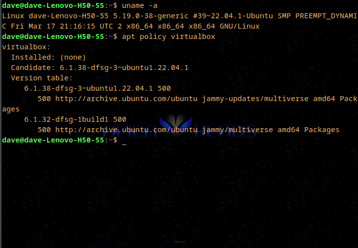

    Can you get to a tty with [Ctrl] [Alt] [2] ?
    If you can: what do uname -a and apt policy virtualbox say? I doubt a bit that the "6" was for the kernel - I think it was for the VirtualBox version…

                        @SchwarzerKater Here's cap of the current listing
                        Click image for larger version  Name:	Screenshot_20230409_124609.png Views:	4 Size:	280.9 KB ID:	669878
                        I don't understand why it says VB is not installed when version 7 is installed. Maybe I downloaded version 7 before checking Discover listings.. Could that be the problem?

                          You did not get VirtualBox 7 from the *Ubuntu repositories for sure but must have installed it from e.g. an external source/PPA.
                          If you don't want to use VMs with bleeding edge systems (kernels) you don't need the newest version of VirtualBox - the one from the *Ubuntu repositories is more than sufficient.
                          Installing software from external sources without being sure about the consequences can turn a snowball into an avalanche - for example the second, fourth or tenth external source could have installed those kernels. Just a theory, and not saying that VirtualBox 7 was responsible…
