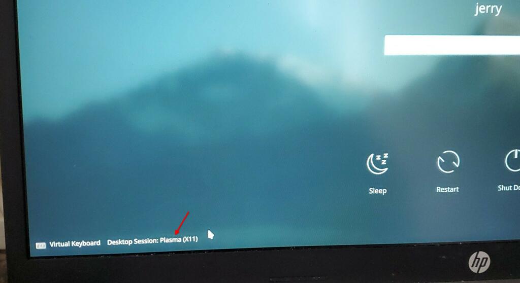

                      Wayland is an option on the login screen, in the lower left corner IIRC.
                        Yeah, the only thing I have in that corner is the virtual keyboard. ^_^;;
                            That's probably because you have not installed plasma-workspace-wayland
                            After you install it you'll notice what the red arrow is pointing to:
