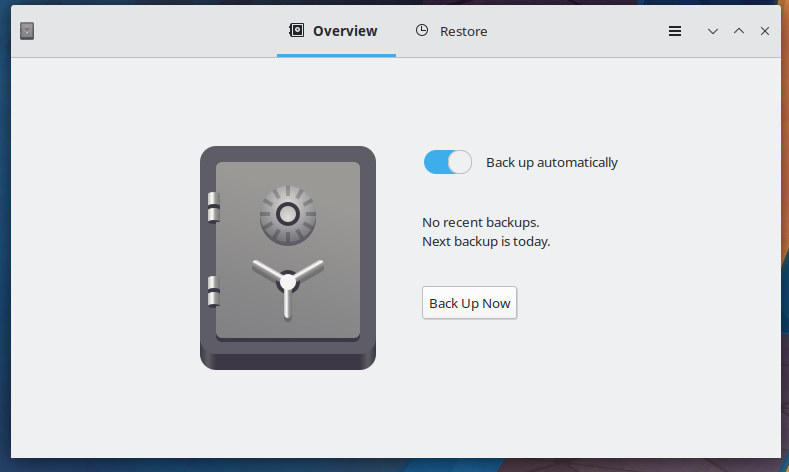

                    Even more confusing now!
                    Applications Launcher/Utilities/Backups launches this:-
                    The 'about' tab say its 'Déjà Dup Backups'
                    Now, the icon in the tray, as you say, brings up 'backup status' but Right-Click shows 'configure KUP..."
                    Am I right in assuming that all these are either relating to each other or are the same thing?
                      Well, this confusion is mostly caused by the weird naming schemes the Gnome guys and girls use…
                      Déjà Dup is called "Backups" as a program name, another example would be "Files" in Gnome - which "in reality" is the file browser Nautilus.
                      The program you use is definitely Déjà Dup
                        No, they are two completely separate backup tools. You already had KDE's tool installed as part of Kubuntu.
                        Deja Dup is the Gnome tool
                        Kup, as mentioned, will not have a menu entry, as it is not a standalone application. You set things from System Settings, and access some parts from that tray icon.
                        it is just that Gnome labels its tools in the menu as 'Backups', and Plasma also sort of call theirs 'Backups' in System Settings.
                        They need have different application names, of course, but they want the obvious thing to show up in menus, settings, and search.
                        If you didn't have deja dup installed, and searched the menu for 'backup', you would find KDE's tool show up, which would open System Settings , as the menu search also searches System Settings, and other items as well.
                        If you search for that term now, you will see both , which does not help things.
